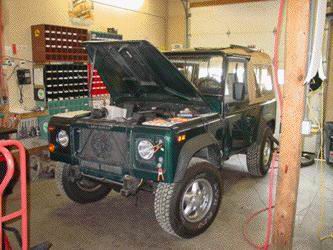

사진1 This D90 has come back to ECR from Maryland for a new round of upgrades. A few years ago we installed an Interceptor 5.2 V8 in this D90, (For information on that 5.2 install go here), as well as a new Badger top and many other upgrades. The customer

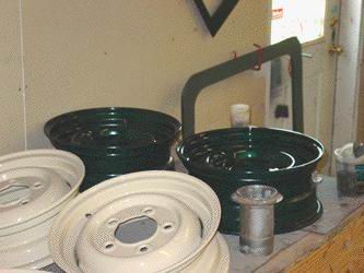

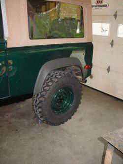

사진2 One of the upgrades for the 90 will be heavy duty steel wheels. In this image you can see that we have epoxy primed and painted some NATO HD steel wheels for the 90 (the green units in the background) and will soon be mounting them with some new SSR

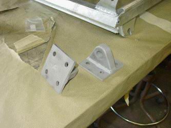

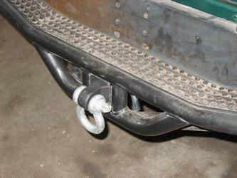

사진7 We will be fitting a Safari Gard bumper to this D90, but we never really did like the Safari Gard recovery points. They are only rated for 9000lbs and with a winch you can easily exceed 9000 lbs. So we made these simple, but ultra tough, recovery po
사진10 Here you can see the NATO HD steel rims that we painted in the body color (British Racing Green) and mounted with Super Swamper SSR tires. These tires will give lots of traction on the trail in either rocks or mud and also give a surprisingly good

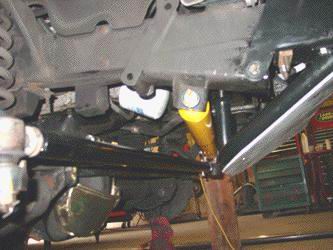

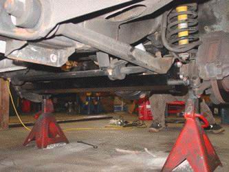

사진11 Underneath the D90 we added some protection so that the 90 can off road all day long and not sustain any damage to the steering gear. This image shows the ECR ROX full tie rod guard. It mounts to the radius arm bolts and gives full protection of th
사진12 In front of the axle we installed an ECR ROX heavy duty drag link, a new Old Man Emu steering stabilizer and a front differential guard. These ECR ROX items, along with the diff. guard and the Safari Gard front skid plate will give this 90 the best

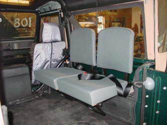

사진13 Here you can see the back of the D90 where we have added 4 jump seats as found in the Defender 90 Station Wagons (hardtops). These have been modified to fit in the rear area without changing the speaker box location, or any safari cage items. We al

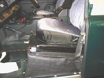

사진14 In the front seats we added a set of ECR seat rails to the drivers seat so that the owner can cruise in comfort without be packed up so close to the steering wheel. For more information on our seat rails go here!

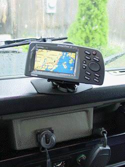

사진19 The customer choose this Garmin GPS unit for his D90 so we installed it with a versatile mount that fits a number of criteria. It allows the GPS screen to be seen by both driver and passenger as it pivots and tilts in the middle. No power or antenn
