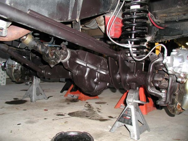

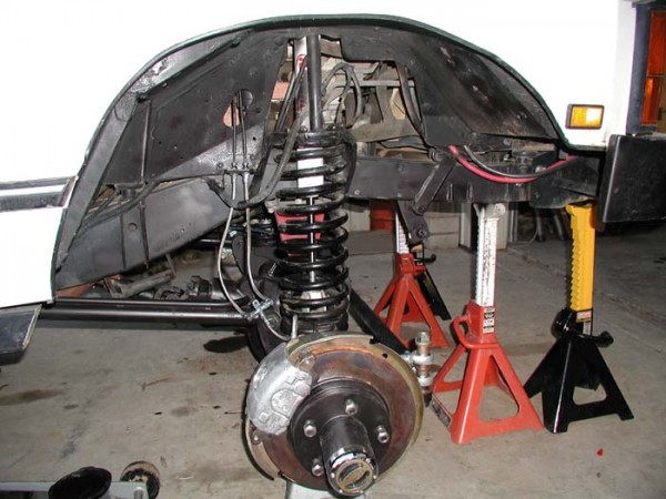

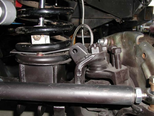

The pictures below are of 1992 Strange Rover Front Axle. The Dynatrac Dana 44 has a high pinion. The tubes are 2 and 3/4" O.D. and have 1/2" walls. It carries Dynatrac 31 spline inner axles. The calipers are GM. The hubs are Warn premiums. It carries dyantrac 4:10 gears and a RD03 ARB Air Locker. The tie rod is custom. It was made by Rockstomper. The rod ends are teflon lined National Rod Ends. The brackets are 3/8" thick. The spring plates are 1/4" box tubing. I have the front axle set up in a three link configuration.
Adam 이란 사람이 한튜닝입니다. fender triming 한건 보이시져
사진1 dana44 stage one
사진2 dana44 stage one entire axle
사진3 drivers side view from front

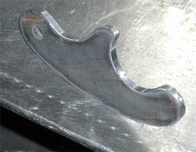

사진4 gbr bronze piece
사진5 mount
