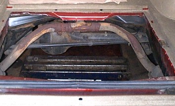

사진1 Initial preparation of the rear floor space shows how rusty 5-year-old stock exhaust systems normally are.
If you think these exposed pipes look bad, The top of the (hidden from view) silencers are normally rusted through completely, so an upgrad

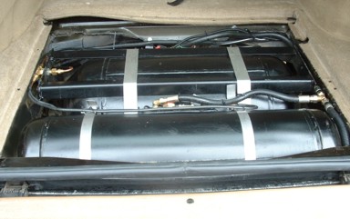

사진2 Here you can see the twin tanks installed.
Both tanks are held with stainless steel ribbon straps, and the smaller underslung one also has a mild steel additional pair of retaining straps.

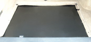

사진3 The tanks are blanked off by the false floor (as seen left) which is sealed and the screwed down.

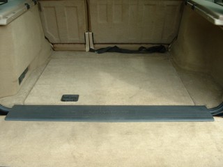

사진4 The finished product!
Loosing absolutely no boot space and visually no difference, this is the most common tank configuration for the Range Rover 4.0 and 4.6 Litre and by far the best.
