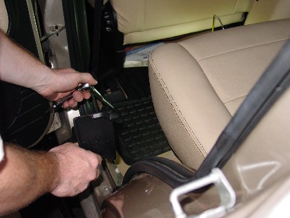

Unpacking the bars took about the same amount of time as installing the first one. Within 15 minutes I had the first one attached, minus the plate which goes under the carpet in the rear floor. These bars were designed so no drilling into the Freelander is required other than the replaceable drain plug on the rear floor between the rear and front seats.
사진4 The carpet has to be partially pulled up before drilling up from underneath so as to avoid catching the carpet with the drill.
This was the most time consuming part of the installation, but still only took a few minutes.

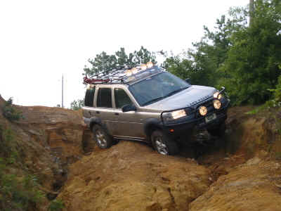

사진8 In action!
Once again the Sliderz are put to the test in North Carolina. Not sure if it was intentional though... :)
