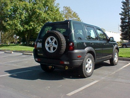

사진1 Photo BUMPERSKID1 is of “Me Beauty”. The lighting was such that the skid is just barely visible. In good lighting though, It looks a bit like the fake plastic skid on the ’04 Hippo.

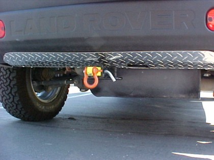

사진2 Photo BUMPERSKID2 is a close up of the skid installed. You will notice that the hitch receiver appears to just float below the skid plate. The square black object to the right is the wiring harness bracket peeking through its hole – I haven’t

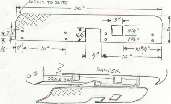

사진3 Finally, BUMPERSKID3 is a sketch of the dimensions of the skid made for fitting to the OEM drawbar. I’m quite sure that the outside dimensions would fit almost any drawbar that bolts into the provided frame mounting brackets on the Hippo. Class-III

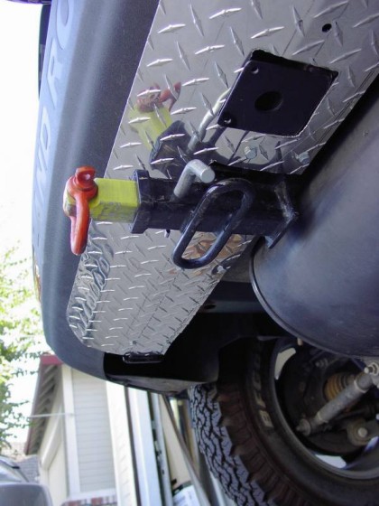

사진4 I bored 8 - 5/16-inch diameter holes as clearance for the ¼-20 x 2 1/2 bolts. I used some 1-inch wide by 1/16 inch steel strapping that was already bored with 3/8 holes. I cut 4 pieces of that to use as the brackets on top of the drawbar. Locations
