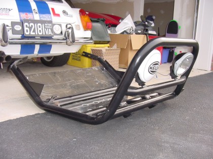

Of course we all know the Freelander is far more capable than most people will ever admit, but there are times when a winch comes in handy. Even if you don"t anticipate ever needing one, the heavy duty A-frame from DAP protects the engine with durable removable plates. Not only that but unlike the oem brush bars, it is strong enough to use for recovering your Freelander. If you bump something with this bar, it won"t fall off like the oem bar will- and that"s not a joke. The way the oem bar mounts, it can actually fall right off!
사진2 After unpacking I decided to test fit the Hella FF1000 lamps which I intend to use.
The plates come installed with an adhesive protective skin, but you will want to remove the plates before beginning the installation.
There is enough room on t

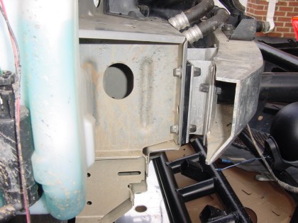

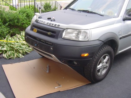

사진3 First step for mine was to remove the oem bush bar that let me down.
Seems that every time I went off road I had to readjust the brush bar because of the terrible mount design they used. The oem bar was obviously just for looks but I need someth

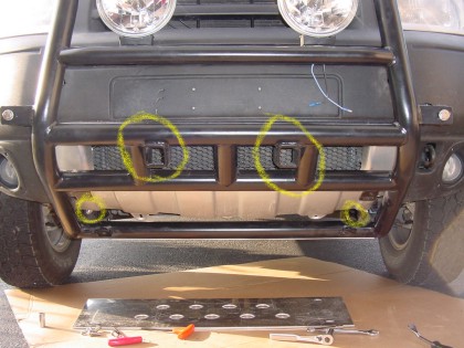

Circled in yellow crayon are the lower mounts and the twin 1.5" receive
