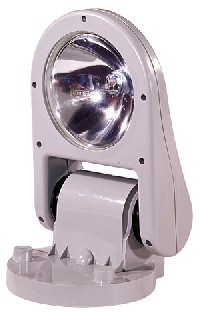

For this project, I decided I wanted a versatile lighting solution. I don"t want a huge row of lights across the top or a police-style pillar mount manual spotlight. The ideal solution presented itself with the Night Probe remote controlled spotlight from Code 3, a division of Public Safety Equipment.
NightProbe NP130H
Permanent or temporary mounts
360 degree horizontal rotation
180 degree vertical rotation
H3 Bulb 100Watts @ 12.8V
7.25"Wx12"Dx4"H (12"H raised)
Wired remote with RF available
Paintable Thermoplastic Housing

사진1 The NightProbe came with a foam adhesive gasket that I adhered to the roof. I also added a bead of all-weather silicone to seal between the gasket and the base of the Probe. The headliner had to be removed to run the wires- which run down the driv
