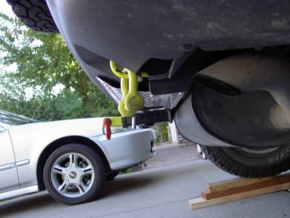

사진1 Free Lander stock muffler!

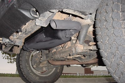

사진3 No chrome dual tips here- this is all business!
Everything was painted black, a second coat is definitely in order once it stops raining.
