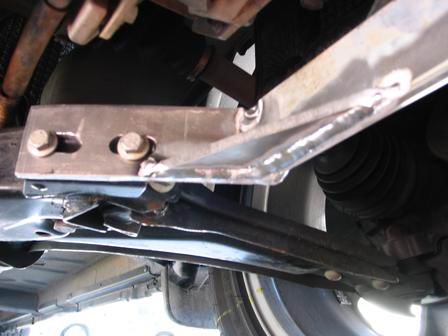

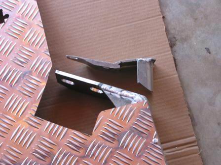

I took my Freebie and broken guard to a local welder and we attempted to weld the OEM brackets back onto the guard. But things did not go well – the OEM bracket was made of thin aluminum and had a complicated support piece that was curved (I’m trying to get a picture of one…) and since they didn’t break cleanly it was difficult to weld them back on. We ended up being off on one side…
사진1 So we decided to build new brackets – bigger and stronger was the goal.
They’re made of 1/4" aluminum and no more crazy twists and bends. The arms of the sump guard were cut back about 1.5" and at an angle perpendicular to the mounting pla

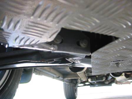

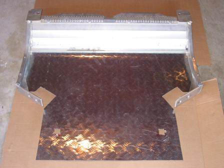

사진2 Here’s a view of the passenger side mount. Note the corner of the bracket near the engine mount has not yet been trimmed in this picture.
The new brackets cost me $130 for 2 hours of labor and the materials…not a bad deal!

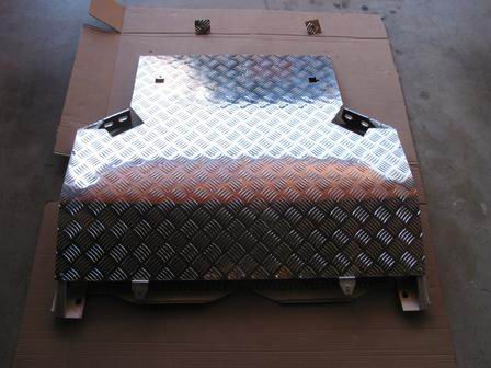

사진5 After some test fitting and some more cuts I had my final product. The guard was cut to length (it covers everything back until the sway bar) and I cut out space for a socket wrench at the new mounts. The plate is attached to the original guard by 5

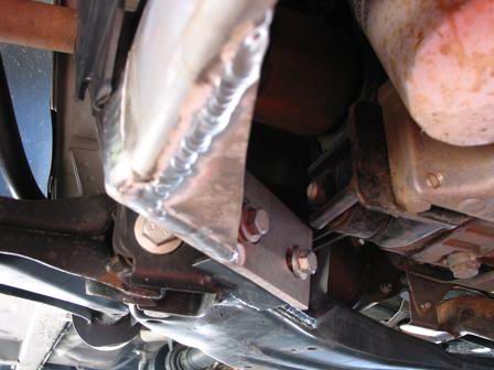

사진6 Another view of the finished guard, this time from the engine side looking down.
From this angle you can clearly see the cut out area for the rear mounting screws. You can also see my early attempts at fixed holes for these two screws. Due to the

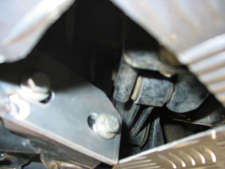

사진10 Close up of the passenger side bracket - here you can see that the corner was cut to allow the engine mount to clear it.

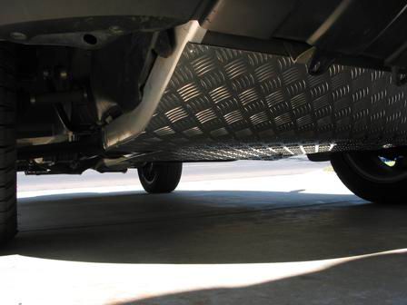

사진11 View from the passenger front corner of the completed plate.
