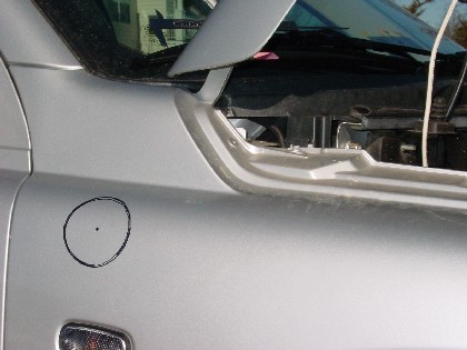

사진1 placed the snorkel against the side of the Freelander and traced the inside of the snorkel mount on the fender with a sharpie. The instructions mention a 75MM hole, but I decided to use the tracing method instead.
An important small detail is to

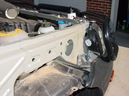

사진4 Now we have the fender completely removed as well as the original air tube. The round opening is where the front of the air tube was connected. The hole itself goes into an air-tight chamber which connects to the intake tube inside the engine compar
