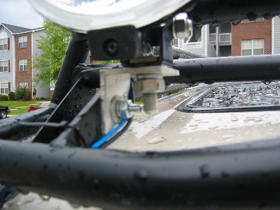

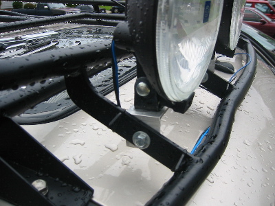

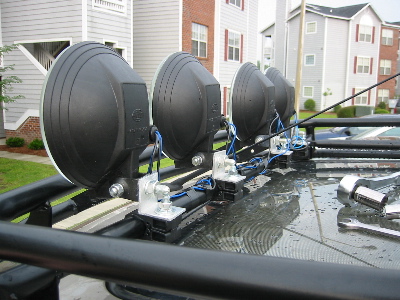

With this installation I used the existing holes that are drilled in the rack. Unfortunately, these holes are facing the wrong way to simply bolt the lights onto the rack. To remedy this, we cut angle aluminum and drilled two holes into this custom bracket. This bracket attached to the rack and then the light to it.

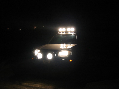

This is the jury-rigged version. However, I like the way it works and I think it looks fine. Some advantages are: with version 1 the lights sit pretty far forward and dump a lot of light into the windscreen. With version 2 the lights sit further back and a little lower and use the roof as a visor. While some light still comes in it greatly reduces the amount and increases visibility.

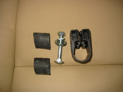

The Yakima Universal SnapArounds cost around $8 and are almost the exact same diameter as the SD rack. You can get them through www.rei.com. To take up the space and make it fit snug I cut strips of an old bicycle inner tube and used them as a shim. The 5/8-2.5” carriage bolts fit perfectly, and I used them to bolt the SnapArounds to the aluminum bracket. With everything attached all that’s left is the wiring.

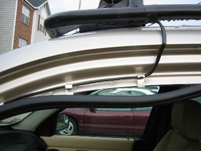

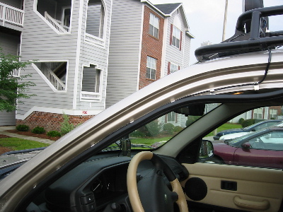

사진4 The lights are all wired in series so that they all come on at the same time. I ran the wires down the driver’s side and used aluminum brackets (the kind used to attach pipe to the studs in a home.) They are shimmied under the rubber door gasket an
