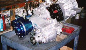

사진3 Fitting the Underdrive to your Rover is quite simple. Care must be taken with the pre-load for the transfer case, but the unit assembles quickly and versions are available to fit almost any LT230 application.
The image above shows an Underdrive ins
